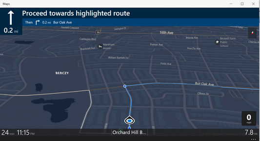

Using an external GNSS Receivers with Windows Maps (or Windows Location Service)
Posted by jack wu on
This document is compatible with the below GNSS receivers: Columbus P-9 Race TOP608BT If you have a GNSS receiver of the type GNSS100L or GNSS200L, please refer to this blog post. You may have noticed that certain GPS receivers that previously worked with certain GPS applications on Windows, such as Microsoft Streets and Trips, are no longer compatible with newer GPS applications, such as Windows Maps. Do you know why this is the case? In the past, GPS apps would typically communicate directly with GPS hardware through a COM port (or a virtual COM port emulator) that connected to a...

Connect a GPS/GNSS Receiver for Windows Maps (Windows 10 / 11 OS).
This document is compatible with the below GPS/GNSS receivers: GNSS100L GNSS200L If you have a GNSS receiver of the type Columbus P-9 Race or TOP608BT , please refer to this blog post. These days, you might be aware that in Windows, those GPS receivers which used to work with some GPS apps (e.g. Microsoft Streets and Trips), are no longer working with the new generation of GPS apps(e.g. Windows Maps). Why? Previously, the GPS apps usually communicate directly with GPS hardware. They go through a com port (or an USB emulator virtual com port) connecting to a GPS receiver. Starting with Windows 7, Microsoft introduced...
